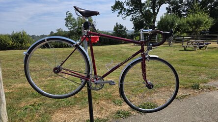

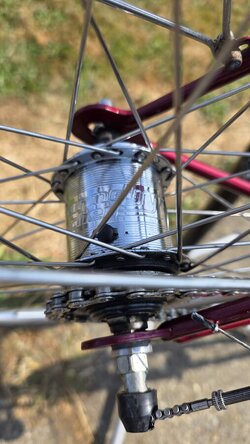

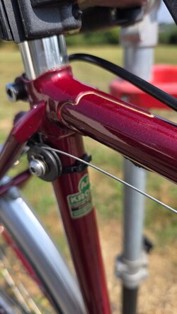

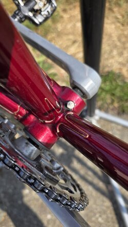

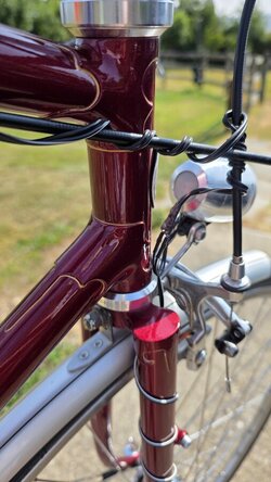

The bikes got covered in muck when the barn was re-roofed, so I've been cleaning them. This one (a pre-war clubman frame of unknown make) was resprayed, and a new fork built, by Argos 18 years ago. It's holding up well considering it's my bad weather bike.
The hub actually has AM medium-ratio internals. Nearly all AM hubshells are 40h, but AM parts except the actual planetary gearset can be swapped for AW parts made up to the 1980s, including shells, drivers, ball rings and the indicator/clutch arrangement, which is far less trouble in an AW.

That frame style looks a lot like a Mercian I had many years ago. Whatever it is it’s lush.
