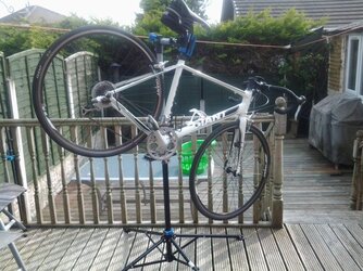

Bought a workstand from Lidl and set to work cleaning the roadie,further fettling tomorrow,lube check everything top up tyres.Ready for the Mancr to Bpool.
It certainly makes further fettling easier,good piece of kit for the money.
