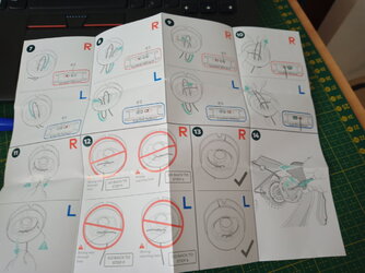

Fixing a BOA dial. Feels like I'm in scouts again, learning knots.
