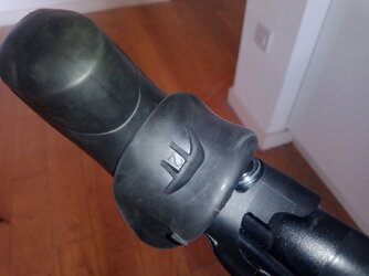

Still in the process of fettling, wrapping handlebars and the hoods have these grooves that sit into the plastic when lowered. So do I avoid taping under the groves? Otherwise the hood won't rest right.
