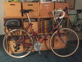

Put a new SR/Suntour silver crankset and some two-sided clipless pedals on Bella.
