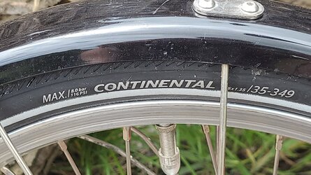

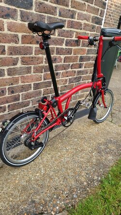

@Tenkaykev How are you finding the Contact Urban's?
tinywheels
South of hades
continental contact urban
I just fitted them
they are much better than the brompton supplied tyres
rolling, cornering, comfort and looks to name a few plus points
you can see how sexy they look in the picture
done over a hundred miles so far and lovin em yeah baby

Yer nut looks a bit slack… 😉
