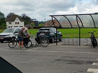

Recently spent two weeks with our son in Belgium.
Many people of all ages there ride bikes and a high proportion are ebikes.
Doing the daily shopping.
