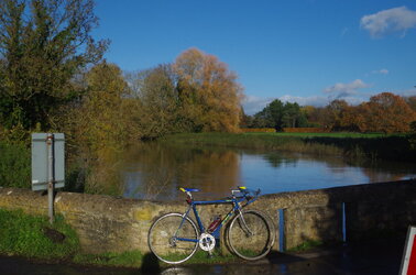

Here is my Italia taken today at Reybridge on my test ride.
