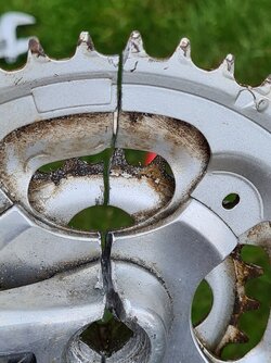

Oh no cutting cranks off doesn't sound like a fun job
I set about trying to fit a new sealed unit this morning. I cleaned out the threads on the drive side of the frame . They look a bit suspect but thought that I might get over that by fitting the non drive cup in first . The non drive side cup had to be removed first. It was tight! Dot punch and hammer. It took a while just moving a few degrees at a time but I eventually got it out. I cleaned out the threads and ran an old cup in. It went in fine. I fitted the new sealed unit cup and then went to fit the new unit. It wouldn't go through! I tried it several times as I couldn't understand what was preventing it ! It was the underneath cable guide! It was sticking up! I put the bike back in the garage in disgust!![]()
I had to cut a crank off a secondhand bike a couple of years ago. Tedious job.
