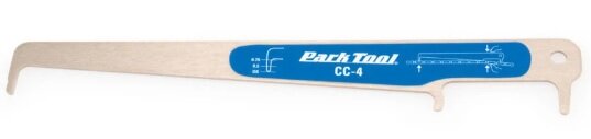

One of my bikes is almost permanently set up indoors on a turbo trainer. Before setting it up, I thoroughly cleaned the (new) chain, by removing it and shaking it up vigorously in a 1 litre plactic container with parrafin and a lid. I repeated that process in four separate containers with fresh parrafin (I filter it through coffee filters and re-use it, so there's no wastage). I pulled it through a tightly-gripped clean rag: no marks on the rag. I use light oil on the chain for indoor work.
After I do an indoor session, I always pull the chain through a tightly gripped clean rag, while pedalling backwards by hand, and turning the cloth frequently to a clean bit. It always comes up black. There is obviously no dirt on the bedroom floor to fling up onto the chain, and the front wheel isn't turning anyway, so I conclude that the black marks on the cloth can only come from microscopic metal particles, as the chain wears naturally, even in these clean, ideal conditions. The chain has over 6000 kms on it now, with 0% wear, according to my Park Tools CC4 chain checker.
So my feeling is that we shouldn't worry too much about the black material on the cloth. Obviously, in normal (outdoor) use, there will be dirt on the chain too, and the things that others have already mentioned about amount and type of lube, regular cleaning, etc. still stand.
