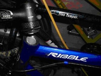

Since my accident * I often hear of CF and aluminium frames & forks snapping. I wondered if any organisation, eg the CTC, BSI, or British Cycling etc is doing any research into the frequency of such failures?
*I was out on the bike and had been doing well over 40 mph {down hill} andthen when I was, 'luckliy', doing less then 20 mph the aluminium fork steerer on my carbon forks snapped off just above the top headset bearing - see below - the handle bars came away in my hands and I fell off my bike, landing on my right shoulder and head, breaking my collar bone {clavicle} and my helmet was broken in several places - but my head was OK. I also sustained cuts and bruises. I was taken to A&E by ambulance, 'gas and air' and morphine en route. My accident was similar to George Hincapie's . . . .
see http://www.youtube.c...h?v=UZg1vrvGbdE
I've since returned to steel framed cycling !
