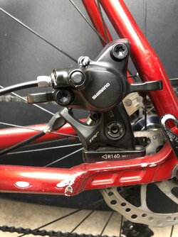

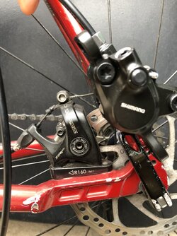

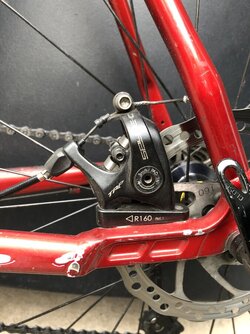

what exactly have you bought and what are you replacing.?
You want to move to flat bars and hydraulic brakes yes?
I assume levers came with the M315 calipers? So then you just need a set flat bar shifters for the Sora so you can change gears....
https://www.wiggle.com/p/shimano-so...?color=black&position=Left&speed40022=2+Speed
be aware the handling and feel might be a bit different as you have moved the effective handlebar axis back quite a bit

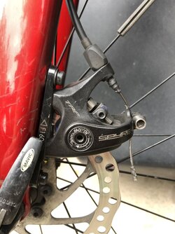

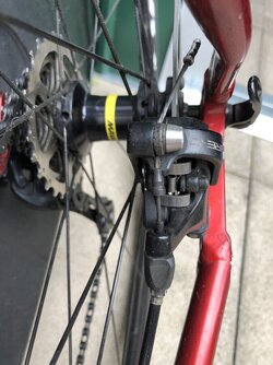

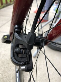

@T4tomo I do currently have Sora dual levers on drop down bars and TRP Spyre C calipers but I want to change them all to flat bar , shifters ( I got the whole set of 2x9 Sora SL-R3000 ) and hydraulic brakes ( I got Shimano BR-M315 set ). The problem I am facing is that the BR-M315 calipers are post mount and the bike has flat mount type on rear fork so I need a different hydraulic brake set to match the bike forks mount type.
I have attached some pictures for a better understanding
