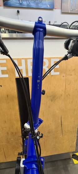

Hello all and thanks for allowing me to join the forum. Unfortunately I have a similar issue with my beloved Brompton C line Explore Piccadilly blue Brompton. I purchased my Brompton in September 2022 and noticed a flaking of paint on the front stem. Since then the problem has become worse. I took the bike back to the dealer. The dealer blamed me for scratching the paint work. I stated that the bike was not of satisfactory quality due to the defective paint work. The dealer has refused to offer a replacement. Any advise please? Picture attached below
All I can suggest is to take a few more photos from different angles and close ups, and get in touch with Brompton direct. ( They have an online chat facility which I’ve found very responsive)
Forward the photos and take it from there.
Brompton have been increasing production a lot, and brought a lot of previously outsourced operations in house, perhaps they’re having problems with processes. Nevertheless they should welcome the feedback.
Do let us know how you get on.
I should send your complaint to Mr Will Double Barrel the CEO giving full details and pics.
