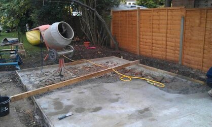

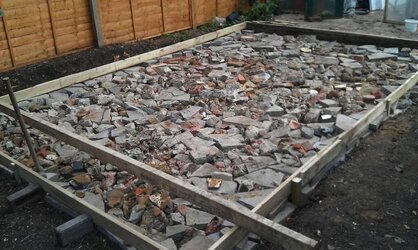

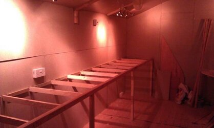

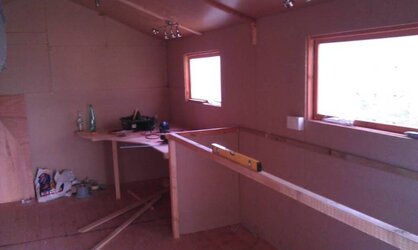

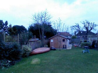

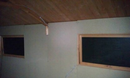

I built my man shed last year and use it as an office and hobby space. It was about £900 for a 16 by 12 medium quality construction. It cost another £500 ish to insulate with 2" expanded polystyrene in walls, under floor and in ceiling. Walls were then skinned with ply.
Its a good solid shed. Warms up fast and holds heat. If you want a space that is more than just storage this method will get you there.
It was digging out the mud root filled bank and pouring concrete foundations that nearly killed me. If going for a smaller shed a few post holes would suffice .
Good luck.
