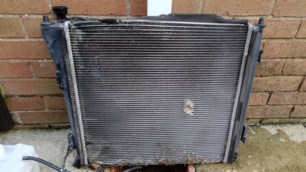

Clutch done last week by clutch man.
I then found then radiators had sold out. eBay to the rescue From a radiator specialist with a 5yr warranty. It's not exactly the same as the OEM but it's equally crappy and fits.
Annoyingly the bottom hose was help on with a spring clip, clearly these are put on before the radiator is installed as there was no was to get a tool onto the clip. It would have made the job a bit easier.
It's a bit of a naff design as the air con radiator sits Infront of the cooling rad. As I split them off the gap between was filled with leaves and crap. I need to remember to clean that.
Refilling was hard work it wouldn't warm up past 75Ā° to burp, but we got there in the end with a brick and a few revs. Not sure I got all the old blue coolant out as my red coolant has gone yellowish. So I'll change it again in a couple of weeks.
