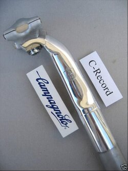

As for the best looking seatposts, you can't beat either the Dura Ace 7400 aero or Record aero of the early 90 - works of art ! :tongue:
Oh man, you think they are works of art? taste is as taste does I suppose
