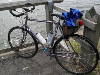

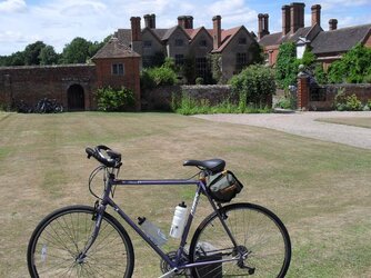

I got the Barley. It is a little tight on space if you want to pack extra bottles or a packed lunch for a day out - but then i do probably carry too much anyway.
I've attached two images, one with and one without the bagman sport bracket, I also fitted a saddle loop bracket which was a bit fiddly. It did initially fit ok by just pulling the straps around the saddle rails and tying back to the post, but it hangs at an angle under the seat which can rub your legs, looks a bit tidier with the support I think.
Bagmansport: http://www.wiggle.co...ort/5360042590/
The saddle loop clamp: http://www.sjscycles...t.asp?pf_id=644
Watch those square washers though! They come sharp if you catch your fingers on the corner of them under the saddle.
In hindsight, I think the extra £10 or so would have been worth it for the QR version.
