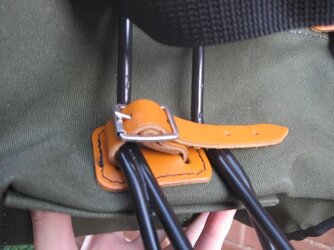

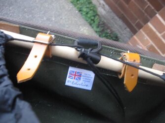

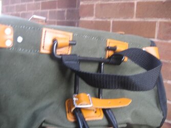

Can someone help me out how to attach things.
This is what I've got and the SQR, well I'm not really happy with how it attaches at the moment.At the moment despite the photos, the SQR bends the back of the bag. I really can't see how it is supposed to attach as although carradice have tried the illustrations aren't totally clear.

I think you might find some useful information/diagrams here.
HTH :biggrin:

Right, so the dowels are on more or less right. The problem is as the photo on that site is that the back of the bag doesn't appear long enough to get the lower strap round the SQR.

Can anybody help? Please? I can't leave the back of the bag crumpled and bent so I'd like to know what I'm doing wrong.

Can the lower strap go around both parts of the rear part of the mounting part? would that help hold it in place lower down if it is nice and tight?
