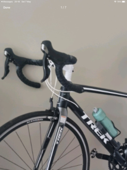

My friend has just bought this bike.
https://99spokes.com/en-GB/bikes/trek/2013/madone-2.3-h2-compact

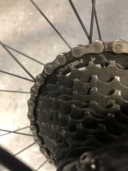

However someone has installed an 8 speed shimano CS- HG200 cassette. They were originally built with 10sp Tiagra cassette.
Will he be able to swap back to a 10sp or 11sp cassette onto the same freehub? I presume a new chain would also be required?

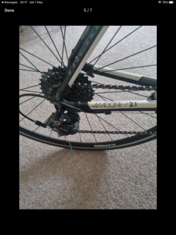

I'm not 100%, but I think they are interchangable, but may need a spacer inserted or removed. My hub is for 11 speed, but with the correct spacers I run 9 speed with no issue. With narrower cassette, spacers just need to be added so that the lock ring can tighten down correctly as the lock threads aren't very long. Then just adjust the derailleur to work correctly - assuming you have the correct speed STI.

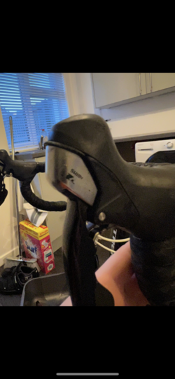

It has 105 front and rear derailleur and 105 10sp shifter.
So I guess he can’t go 11sp 105 cassette as shifter is only 10 sp

As skolly says, something is not right as 10 speed is much narrower spacing

I assume it could go back to the correct cassette if the correct adjustments were made to rear derailleur?

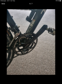

Photo of front shifter, and photo of rear derailleur and cassette in each gear , taken from behind please.
I don’t have that unfortunately
It’s a guy from work. Not my bike.
This is all I have
