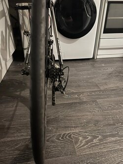

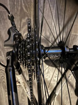

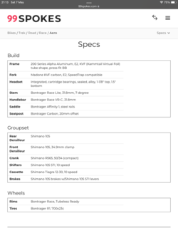

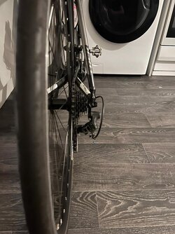

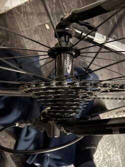

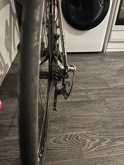

That’s the spec which is the case apart from the cassette Is now an 8spd as in previous pic I uploaded
doesn’t add up at all to me what’s been done to it
Edit- He’s just told me he has to click twice on shifter to change gear on some gears….! The plot thickens

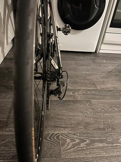

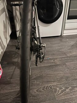

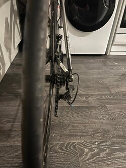

Some pics
DRM
West Yorks

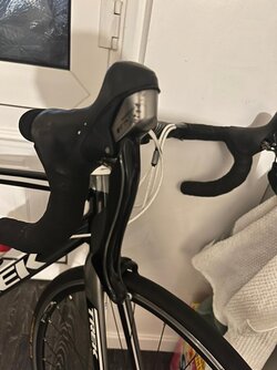

It must have Claris shifters fitted, I can’t see how 10 speed 105 shifters can change 8 gears, something stinks about this bike, I do hope it’s not stolen, or a heath robinson thing that’s had the 105 group set robbed off it to go on another bike that had Claris fitted, and then been sold at an extortionate price so the seller gets a 105 group set for nothing

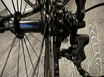

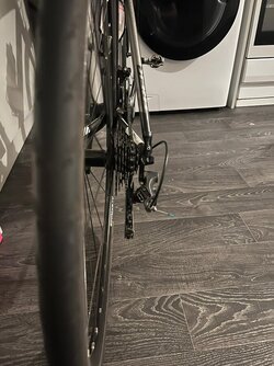

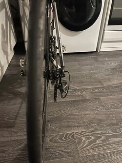

The 105 STIs are 10 speed. The cassette fitted is 8sp. It's not shifting properly. Procure and fit a 10sp cassette (you'll need a 1mm spacer next to the flange, will fit on the freehub). Adjust and index gears. Ride on.
Thanks for confirming
fraz101
fraz101
Is the 1mm spacer to stop free play in the cassette once the lock ring is tightened?
I’m unsure what (if any) spacer is fitted currently to the Freehub, as it’s on an 8spd cassette just now.
