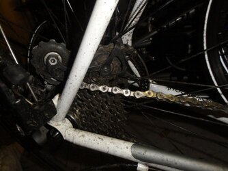

So on the way home, with no warning, my rear wheel locked up and I came juddering to a halt.
It was on a 40 limit dual carriageway, so I was pretty lucky I think - the car behind me was some way off.
Somehow I managed to unclip and stay upright, and hobbled over to the side of the road.
My rear mech was in the spokes.
I can only assume that the chain partially broke, jammed, and dragged the mech up into the spokes.
In retrospect, there had been a faint clicking once a chain rotation for about 5 minutes.
Is there anything I could have done? The chain is fairly new - it really shouldn't have failed like this.
Lucky I haven't got round to selling my hybrid yet.

That is catastrophic! You must have legs like a machine to have bent the mech that far out of place! It looks like you hit a landmine!

Normally it occurs when the stop screw is not adjusted properly, that combined with the flexing of the rear triangle. there may of course be other reasons.
Globalti
Same thing happened to Gti Junior when his plastic-bodied cheap Campy derailleur snapped and wandered into the spokes. He had been hearing a clicking noise for a few minutes before and he ignored it, then bang. It was fairly catastrophic.

Same thing happened to me on a SMRbtH from Brighton.
Caused by my saddle pack bursting open and shedding my Montane jacket into the gears.
I had just turned off a dual carraige way doing about 30mph when it happened.
Jacket wrapped around the cassette and tore the deraiileur in half and twisted the chain.
