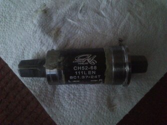

To lower the gearing by modification up front, you can consider replacing the existing 52/39 chainset with a compact chainset (usually 50/34). It is likely that you would not need to replace the front mech, but it should be moved down the seat tube by 4mm (assuming it is perfectly set up currently). If the current bottom bracket is sound (you can feel for any roughness by shifting the chain off the chainset), and if you do not want to change it, you will need to pick a compact chainset that delivers close to 43.5mm chainline with a 110mm JIS bottom bracket, or else you may end up with front shifting problems. You do not have to change the chain, if it is sound, if you are lowering the gearing by only changing the chainset.
