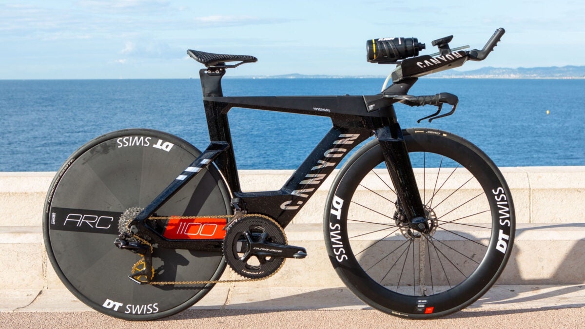

And for @Big_John a chain tool/cutter is safer and almost as quick as bolt croppers. Cut a rusty chain yesterday on my daughter's first (10 years ago) road bike - abandoned and no room in the inn for it, so I repatriated it, to Devon. She has others now, with this (image from Nice a year ago) being the sharpest weapon. 21 days to IMWC Kona, ftw.
https://cdn.triathlete.com/wp-content/uploads/2024/09/5P5A1604-3-1200x675.jpg
Note: Velominati rules followed: chain on the big dog and valves at 6 o'clock. Cranks not at 90 degrees. And no, that chain is not 'rusty' gold.
