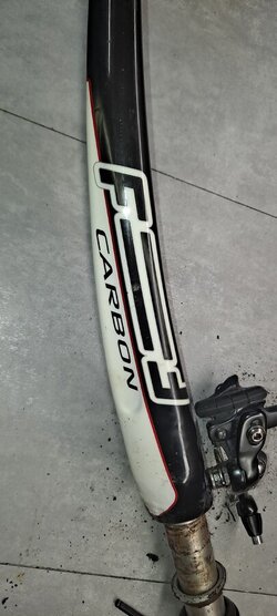

OP - I'd get that fork checked out as it's a critical, heavily-loaded part with nasty consequences if it fails; and that bubbling (presumably ally corrosion) could be more than cosmetic.

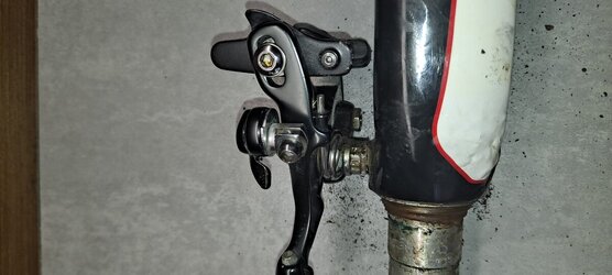

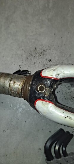

well that was an adventure getting the brakes off, rust and time made it a job 🫣
bubbling i was talking about..
these could be a carbon fork? have it emblazoned on the side...?

Carbon fork, but with alloy steerer tube. Not uncommon, even today- my Viner of similar vintage is the same, I imagine my Trek is too.

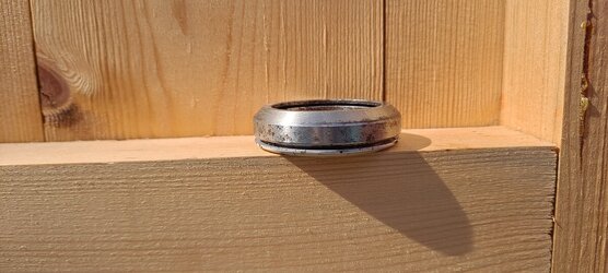

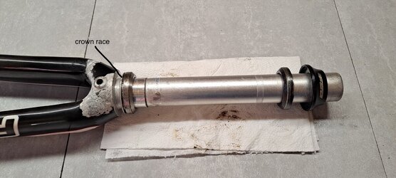

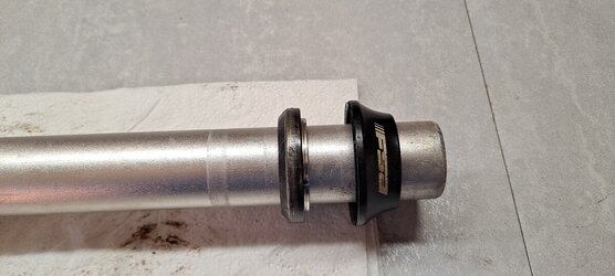

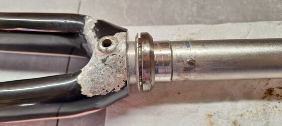

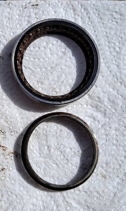

can someone help me with the anatomy of my front fork.
should there be something between the crown race and the bottom bearing?
the bearing doesn't fit snug against it ..
also the bottom bearing opens to show the bearings. i thought it was broken but i believe some do open
i'm going to replace it anyway as it's pretty bad looking.
will it be ok to replace with a sealed bottom bearing?
(i've removed all the bubbling, plan to touch it up with paint)

I'd also check the carbon blades are well glued into the alloy crown. This is where you want to be doubly sure they are rock solid.
