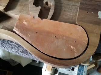

Curved tin snips would be my choice
You can get left hand and right hand snips....your cutting it the right way ? Not trying to be patronizing !
that could be it. I am cack handed![]()
Coincidentally, just saw someone cutting copper sheet like this on Salvage Hunters-The Restorers.
Used a Dremel-like tool with a circular rotating blade.
Amateur 🙄I ended up using the jigsaw. Found a set of blades in Dad's garage which had some very fine looking metal cutting blades, so sandwiched the copper 'tween two chunks of MDF, clamped it up and cut it to shape.
Thanks for all the suggestions. Ask a cyclist is always the best thing to do![]()
