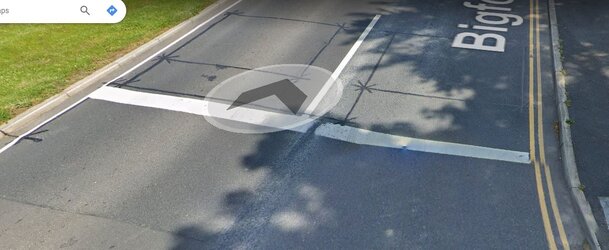

I've just had a look on Google Maps & I'll have actually stopped in one of these...
PaulSB, that's where I'm at :smile:
