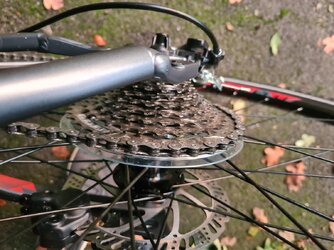

I now have a new issue since I got the bike back.
Took it for a decent ride, probably around 4 miles, and the 2nd gear makes a noise. 1st gear also but less so.
Why would it do this after just a bike clean and puncture repair?
I *think* it might be the chain rubbing against the front derailleur or might it be rubbing against the chainstay?
What is the fix?
What is the fix?
The rear wheel has been taken out of the frame to fix the puncture.
Make sure the wheel is square between the stays, and positioned and tightened correctly.
The indexing may need some minor adjustments. Plus if the bike was washed, lube the chain, making sure it's not dripping in oil.

He lubed the chain too. I'll take it back to him to let him know of this issue. I believe it's his responsibility to ensure the bike functions as its meant to after any changes he makes right?
Also I feel before I gave it to him the drivechain was very smooth. It's not as smooth anymore when changing. Takes a little while longer to change gears compared to before to after selecting a new gear. gears.

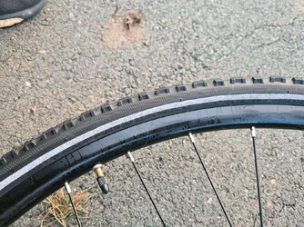

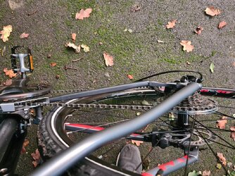

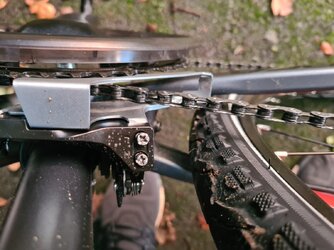

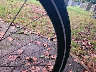

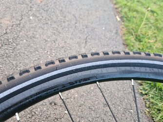

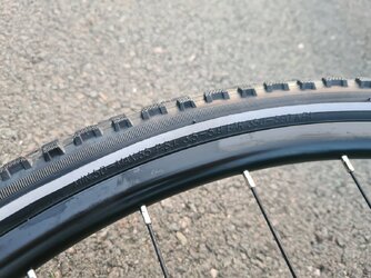

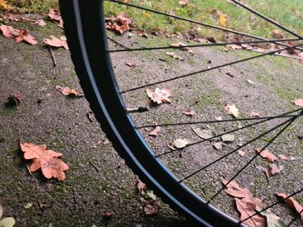

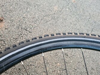

Photos. I was on low battery so was rushing to take the photos, so not all are great.
Tire side photos taken to show information about tire that's written on the sidewalls.
Drivetrain photos to show how the chain sits in 1st gear. Look at the front derailleur.
Photos of valves that sadly aren't in focus on the valve, to show and ask why the valve is shorter than the valve on the front tire which is still the stock valve and if it matters.

Valve length doesn’t matter as long as you can get the pump head on fine.
If it bothers you however, just fit a new one with the same length valve and keep the other on your bike as the emergency spare :smile:
Thanks
That front derailleur hasn't moved quite far enough. You probably want to loosen the 'L' screw, probably by less than half a turn.

I'm not 'having a laugh'. Just because all of you have cycling knowledge, including words used in the cycling world, doesn't mean everyone does.
When referring to parts of a cycle, I have to google 'bicycle diagram' so I know what they're called. Because this isn't something that you're taught in school nor is it something most people go out of their way to learn.
And I'm right in saying no one had properly explained what the C was for. This is literally like a new language.
700x42C.
No measurements labeled on the numbers. Absurd. Who tf does that? In maths we, the British citizens, have all been taught to LABEL numbers correctly where applicable. So millimetres or centimeters etc.
But surely that shouldn't need adjusting? Isn't it that the rear tire needs to be put on correctly as that's what was moved?
