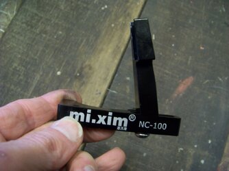

The mount for a front derailleur arrived today
https://www.ebay.co.uk/itm/315754560971?var=614182664648
I thought I'd do a 'trial fit' prior to the arrival of the Shimano front derailleur which despite a '48 hour' delivery seems to be lost in the Royal Mail network :rolleyes:. I haven't been able to win an auction bid for the 36T chainring I intend to use either. That aside I could experiment with the mount and an old Suntour braze-on front derailleur I have in my spares. The mount size is 40mm as expected, so I have 1mm thick double-glazing packers at the ready to take up the slack around the 38mm seat tube. I guess if I heat them in boiling water I can 'mould' them around an odd piece of tube so they'll be an easy fit around the seat tube. This mount isn't perfect, but it's better than I can source from a UK manufacturer (thank you China..... whatever happened to UK manufacturing?). All is not lost, so using a file I intend to make the shape of the upright a better match to the front mech, and where the upright attaches to the band could also be improved to give it more stability it so it isn't totally reliant on the clamp screw. The joys of modification :laugh:

One problem with this mount is that it does not adequately prevent the rotation of the holding finger. The second problem is that the bulky band is eating up the space for the derailleur cage. Still, it is better than nothing.
The Shimano front derailleur arrived today and the shape is an exact match to the 'finger' (your good description btw) of the bolt-on mount. The Suntour front mech I tried yesterday was different, and I wonder why? Maybe the braze-on mount was different on the bike it came off (a Rudge Montague folder)? I can file the lower part of the finger so it goes into the slotted part of the mount - If I do it very carefully it can be a close fit which will prohibit rotation without being totally reliant on the screw. I can appreciate the issues with a triple front changer - there is certainly room for the double, but yes, a triple can't be easy to fit. One thing I measured was the distance from the rear triangle hinge to the BB centre as 95mm, so when the rear is folded under the chain is effectively 190mm too long - disregarding small angles, this meant 190mm (7.5 inches) of chain slack, equivalent to 15 half link of a chain which suggests whilst using the bike there can be 30T difference of the chainrings without a problem. Clearly folding the bike with the chain on the largest ring is probably wise. I note the standard Brompton tensioner is about 100mm centre-centre.
Suntour front mechs expect a shallow cavity in the mounts. Maybe that was usually the case with the braze-on mounts early on.

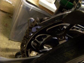

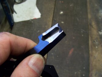

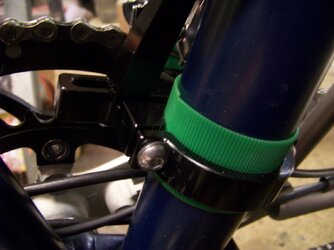

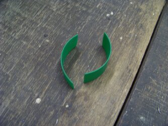

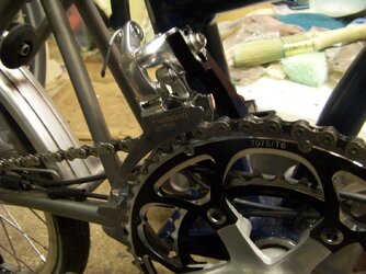

After receiving the 36T inner ring a few days ago, I've been fettling parts today. The mount for the front derailleur has a couple of issue, but they have been overcome. It changes between the ring in the workstand, and a road test will follow in due course. With the chain on the big ring and small sprocket the chain causes no issues when the bike is folded or unfolded. I fitted a suspension lock-out control for cable control of the front derailleur, and although this feels tough to move when the bike is in the stand it may be ok when I'm on the bike - I may change it to a Sunrace shifter. Some photos follow. 1) There is an angled face to the finger which means the clamp bolt/washer of the front mech isn't flat to the surface. 2) I cut and filed 2 grooves so the finger goes into the slot of the mount - the slots prevent it from turning and give more security. 3) Using a dremel I tried to spot-face the angled area of the finger to make it parallel - this was a mistake, so I then used a file. Not pretty, but it did the job. 4) two pieces of window-fitters plastic shims were cut to length (60mm), put in boiling water and then moulded around a 30mm tube to give them a curve which made fitting easier. 5) Because the clamp is 40mm (tube is 38mm) the 1mm shims are ideal, don't damage the frame and the mount is secure. 6) a view of the set -up 52T and 36T rings. 7) with the Brompton folded the chain mostly stays on the big ring, and doesn't fall off when the bike is unfolded. Good points about the derailleur mount..... a) It's available. b) Relatively cheap. c) there is good adjustment up-down fore and aft of the finger and the derailleur clamp position, and of course it's possible to move the clamp up and down on the frame tube. This is probably better than having a braze-on already on the tube (unless the position is decided prior to spraying)

After receiving the 36T inner ring a few days ago, I've been fettling parts today. The mount for the front derailleur has a couple of issue, but they have been overcome. 2) I cut and filed 2 grooves so the finger goes into the slot of the mount - the slots prevent it from turning and give more security. 4) two pieces of window-fitters plastic shims were cut to length (60mm), put in boiling water and then moulded around a 30mm tube to give them a curve which made fitting easier
Smart!
