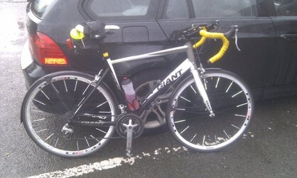

i have the giant rapid 4 see pic attached. They take 10 minutes to take off and refit - a bonus in this weather.
