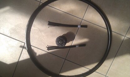

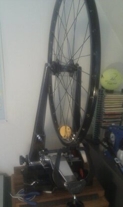

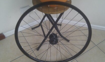

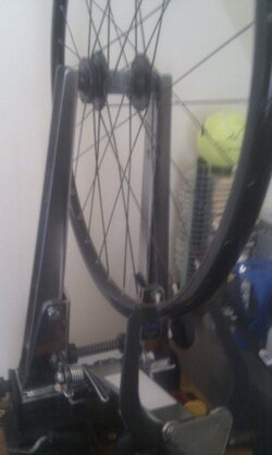

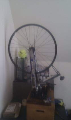

I took the day off work to take care of some personal business. After that, I spent some time rebuilding an old wheel for somebody. I felt like taking some pictures so I will share them with you.
IMAG0472.jpg IMAG0473.jpg IMAG0475.jpg IMAG0476.jpg IMAG0477.jpg IMAG0478.jpg
Someone has a wheel that had given up, back in service now ^_^

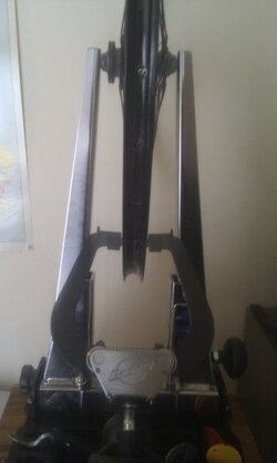

Just out of interest what equipment have you had to shell out for first? Is that a Park tools wheel truing jig ? Also are you using a tension measuring tool? Really keen to start building and repairing my own wheels for myself and the kids.
Yes, that is a Parks Tools truing stand. I also have a dishing tool,a tension meter, a few spoke wrenches and nipple drivers.
