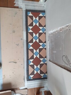

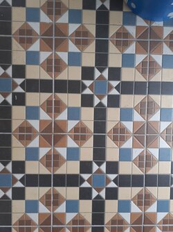

We have this pattern in the porch from Wickes large tiles. For the hearth I had to do it the proper way with individual porcelain tiles cut to size with a wet saw
