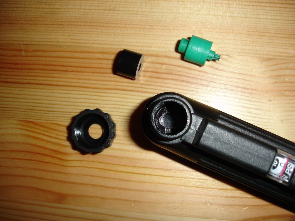

Does your pump fit both Schrader and Presta valves??
On the little hand pump ;) I have, you have unscrew the valve on the pump, then flip the inside over depending on which valve you require.

Are you sure, mate? If the valve is set up to Schrader (which it will be by default) then you need to unscrew the cap, take out the rubber, take out the plactic pointy thing and switch it round, and then also switch round the rubber thing, and put them back in, then screw the cap back on.

Moonlight's description is a lot better than mine.
I've managed to take a photo of my dissected pump... the pointy end of the green plastic thingy is for schrader and the fat end is for presta.
To get the piece of rubber out, it helps if you pull the lever out... once you've unscrewed the cap.
Hope this helps... good luck.
