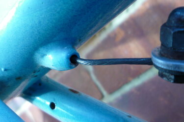

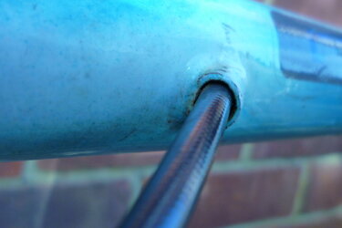

Anyone know how to replace a rear brake cable on an old GT Tequesta? Advice and suggestions gratefully received.
I'd like to remove the brake cable to clean it up or replace - depending on what I find. Problem is, the sheathed brake cable disappears into the frame (top tube) at the front and the inner brake cable (wire) emerges through a very small hole at the rear end of the top tube. I've no idea what arrangement GT used to guide the cable inside the top tube, if anything, so I'm reluctant to pull out the cable until I better understand the arrangement because I may be unable to return it. And if I can't physically return or replace the cable, I'm looking at a whole new rear brake setup.
I have the same bike as this:
http://si6.mtb-news.de/fotos/data/16420/IMG_6546.JPG
Whilst you can't quite see the cable disappearing into the front end of the top tube, you can see the inner wire emerging at the rear end. Thanks for reading.

I get the gist, however, the hole in the rear end of the top tube (through which the rear brake cable wire emerges) is truly small - just large enough for the wire only. Certainly couldn't use a ferrule or cable end cap or tie fishing line to the wire at the rear end and pull it through from the front. Maybe sewing thread would be sufficiently fine - I'm amazed the glue held though. Will give it some thought.
I obviously can't see inside the top tube but I imagine the outer sheath continues inside, along the length of the top tube, and the tiny rear end hole holds the sheath back, just allowing the wire itself to pass through to the brakes.

Thanks Drago. My only concern about this method would be if the cut end of the new inner wire started to fray as I wiggled it along inside the sheath. I'm not sure how smooth the inner surface of the outer sheath is. Also, I'm assuming that the outer sheath travels all the way along inside to top tube until just before the point where the inner wire emerges at the rear end of the top tube. This is a job that will likely be required at some point, however...
