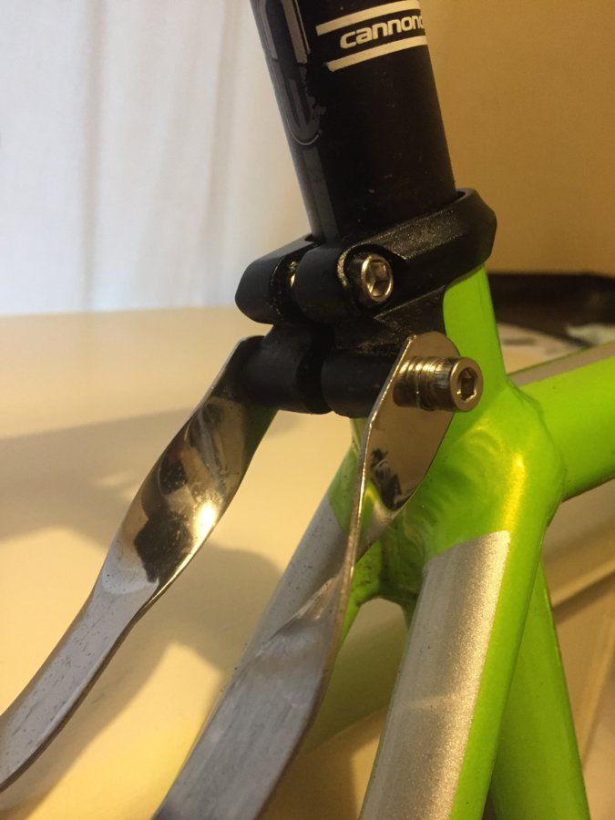

Here is a pic of the fitting. I have added a split washer between each bolt and stainless rack arm.
Is this the best side to fit the washer? Is it worth adding another one the other side of the rack arm, to sandwich it with washers?
Time will tell. My money is on it coming loose again. The rack stays move up and down and I suspect the bolt will ratchet out. But keep us posted, it should be interesting. Movement is not the same as vibration.

Just a plain washer under the head will stop most bolts from loosening. Such has been my experience.

I would shy away from a Loctite "thread locker". They tend to do what it says on the bottle, and you may never get the fastener undone. Go for a "low strength retainer". Whatever you use, clean the threads with IPA before applying it.

There are many grades of threadlocker. "low strength" is what you want here. Loctite, a leading brand, have data sheets to guide you through their myriad set of products, each with a code number and various attributes such as chemical or heat resistance, but conveniently also say "low strenght", "medium strenght" etc on the bottle. The higher strenghts aren't intended to be undone ever, so don't just think higher strenght is better !
Well I commuted today, albeit just 12.5 miles total but the rack has stayed tight. I won’t be satisfied until it stays tight with a heavyish load and a good few weeks of commuting but it hasn’t failed immediately which is good :smile:
BurningLegs
BurningLegs
Well I’ve now done a week of commuting, including two “heavy days” (laptop, shoes and other bits and bobs carried) and the rack has stayed nice and tight.
Thanks for all the input here guys. Initial signs are good that the split washers alone may do the trick for less then £1 spend! If it comes loose again within a couple of weeks I will get some loctite, but if I need to tighten it every now and then I can live with that.
