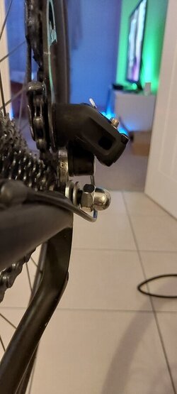

Ive been riding like this for ages, didnt notice a difference as the disc brake lined up and gears seemed good somehow. Now i got a puncture and cant get the wheel off. The silver bit looks separate and the bent bit, is it a replaceable part or bendable.
Bike is a 2011 boardman hybrid pro

From that pic - your nut has come loose and the axle has bent ? If you bend it back it might snap at a later point.
Take it into the bike shop and they'll replace that for you - they might need to saw it off to let them pull it out the other side.
You can just take the tube out of the tyre and repair it without taking the wheel off if you have to.

I’d like to see some better pictures before I condemned the poor thing but the axel is out of the drop out, so the opposite side drop out is likely bent. It might be a fight to get the wheel out but if you remove all the axel hardware and perhaps the derailleur you should be able to see what is bent and how to get the wheel free. If the drop out is bent a little its worth trying to straighten it. If the hanger is bent it can be replaced.
Its possible you could unjam things by loosening the hardware and trying to reseat the wheel into place.
Looks like no more than a one beer job, two if you over think it.

Hard to tell from the pic. Maybe the dropout hanger is bent, could be the axle. But i wouldn't have thought that the bike is condemned in any case. You'll need to have it/inspect it further. The dropout hangers can be brought and replaced and look similar to these.

Doesn’t this model come with qr skewers? What prompted the change to solid axles? Axle looks bent but doesn’t mean the frame is ruined, but an axle is going to take quite a bash before bending. Should come out with a bit of persuasion, then you can ascertain the extent of damage if any.

Looking further at that image I wonder if whoever has put a dome nut on the end of a solid axle and (of course) cannot tighten the nut/washer against the drop out. Maybe other side too :rolleyes:
For the OP (their first post in 8 years lurking): no, your frame is not 'ruined'. You might find the 'taking the rear wheel out' evolution a darn sight easier if you kept the bike upright.

Its cool guys i had the nuts loose, ahem, now i know what a dropout hanger is I've taken the derailleur off and theres two little screws to remove it. Unfortunately they undo from the inside and the bent hanger is stopping the wheel coming out. Considering trying to lever the hanger out a bit to get the wheel lose.
Also well noticed its had an electric conversion so different axle.

That explains the nutted solid axle.
You can use a adjustable spanner opened so it just fits over the hanger to straighten it. Remove the derailleur first of course.
The hanger is there to 'save' the frame in the event of accident.
