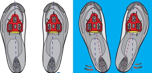

Most find it easier to unclip with a straighter leg towards the bottom of a pedal stroke than with a more bent leg at the upper part. Some do get a sore knee with repeated unclipping, commuters in busy urban areas for example.
You can reduce spring tension on many pedals which helps, as does correct cleat positioning, especially if your cleat rotation does not match what you need. If your natural rotation is 'heel in' and your cleats are set 'heel out' you have to rotate further than need be if set correctly to unclip for example; which again can aggravate knee issues and that's before you take into account that's it's not a good for your knees to have them set incorrectly in the first place as you will be twisting your leg to replicate your natural rotation each pedal stroke. You can check what your naturally angulation in a few ways, two basic options would be glancing down at your feet when you walk (ideally when not wearing shoes, see second pic' as an example) or sitting on a bench, table etc and letting you feet dangle and note the angulation/rotation. There can be more to it than that but that would be a start.
In my illustration the first picture is someone who does not have any rotation and in the second for someone who has a more common heel in rotation. If we used a clock face as a reference the first shoe pic' would be 12 o'clock and the second say 11; you'd rotate the second 'more' or 'less' as required to mirror what you need. You'd note if there is a difference between left and right as often we are not symmetrical when it comes to rotation
