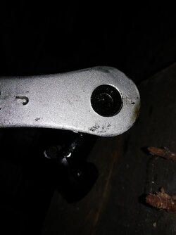

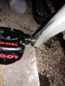

I bought a bike secondhand and it came with LOOK pedals fitted but I can't get the fkrs off as the flats where the spanner goes is rounded off. so here's a couple of photos ...
I'm almost resigned to buying compatible shoes but I've never used LOOK shoes....what type of cleats/shoes do I need for this kind of pedal. When I collected it, rode it using Adidas samba trainers.

I think those pedals come off using alarge allen key on the inside of the crank arm - they dont have 'flats'. You will need Look cleats - but be aware that there are different ones in the Look range so check compatibility with yuor pedals

Shoes with three-bolt fittings, yes like the pic, cleats like these: https://www.lookcycle.com/uk-en/products/pedals/road/cleats. I'm not sure if Look have ever changed the pedal/cleat interface (like yourself, SPDs here), if in doubt go to an LBS and check/buy there. Cleat covers are available for walking (the cleats are exposed so you don't want to walk around in them), but it'll be for short distances- cafe stops etc- only.

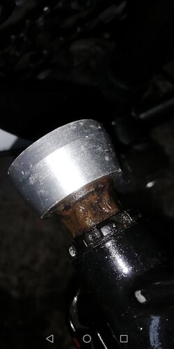

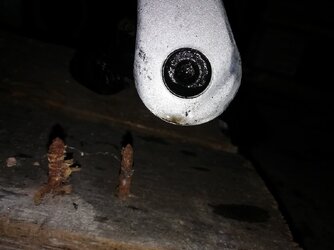

Mate, here's some tantalisingly poor pictures of the back of the pedals... can't tell if there's a hex fitting there because the light is so rubbish. I'll take some more later, cheers.

It'll be a hex of some size.
Yes mate, i offered up the largest hex key on my multitool and it deffo fits. Now the problem is not enough strength /leverage to turn the hex bolt.... Yes I'm turning it in the correct direction.

Have come across pedals like this and yes defo an Allen key as others have suggested.
I think you will just need to persevere.
I think I'll need to get the biggest fukoff 8mm Allen key I can find to get more leverage. I reckon previous owner spun these on without any grease FFS.

Can you take a photo of the pedal from the side, top and bottom.
There are just two types of cleats - Delta (old type) and Keo.

Yes mate, here...
For info, at rest, the pedal is biased so that the point end is uppermost.
