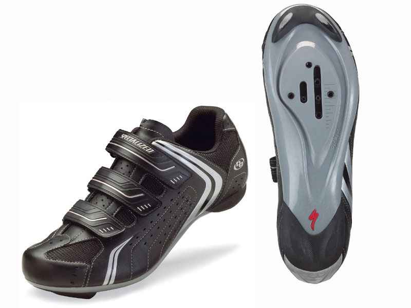

I can't decide whether to go for MTB (with SPD pedals/cleats) or road shoes (with SPD-SL/ Look etc.).
I have narrowed my choices down to Specialized MTB Comps or Northwave Lizzard SBS in MTB shoes, or Specialized Elite or Northwave Typhoon SBS in road shoes (purely because they are the only two makes I can get a good fit in).
As about 90 percent of my weekly mileage (75 miles ish) will be on the road bike, I am tempted to get road shoes, but as I want to do some off road stuff, I am torn between off roading in my trainers still and just having road shoes, or having a pair that covers both (am I making sense).
Is there much difference between road and MTB shoes for road use and are there any benefits of a three bolt cleat system over two bolt (SPD) etc.

Road shoes are lighter and road pedals generally attach to the cleat on one side only.
SPD pedals have attachments on both sides of the pedal so would be better for stop - start commuting
Most road shoes have very limited grip on the sole with the cleat protruding so are tricky to walk in. MTB shoes have chunky grips and a recessed cleat so are better for walking in. There are some in-between hybrid shoes from Lake that will do both road and trail.
I'd go with SPD and hybrid shoes for commuting/leisure myself.

I use MTB shoes for commuting as I can wear them at work all day, if you get SPD SL road shoes you will need to have something to change into when you get there...
I use SPD-SLs on my summer bike and if you have to walk more than a few feet forget them any benefit they deliver over spds just isn't worth it. On my winter/ general bike I use spesh bg sport with A520 pedals and I find these offer a good in between. For the work I don't cover enough distance, so I don't really worry and wear cheap lidl mtb shoes with M424 spd pedals.

GO for the SPDs and a pair of MTB trainers. Unless you are a serious roadie, the extra weight will hardly make any difference, and they are far better for walking in off the bike.

Every poster (incl me ) has recpommended that you get a pair of MTB shoes as they have recessed cleats and grippy soles which you can walk normally in and wear all day at work should you wish to.
You have ignored everyone's advice and decided to buy road shoes which are impossible to walk in and give no advantage whatsoever for your use .
