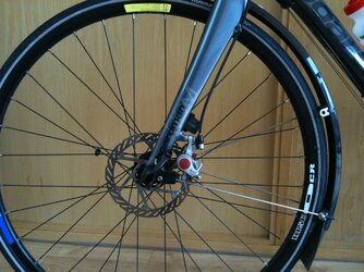

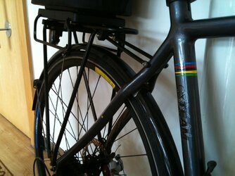

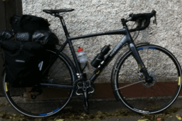

Ok... pics attached as promised.
Apologies for the poor quality of the first. That's the laden bike in full touring mode.
In the second pic you can see where a lengthened link or some kind of extension would lower it more neatly down to the tyre. It's not a huge problem... only if you're picky. Also, i think due to the clearance you'd probably get this problem with most guards
Third pick shows the rear rack. Obviously I've got the ortlieb adapter for the trunk bag on there too. It's a bit bulky and weighty, but taking the rack bag off with one push of a button is very handy!

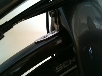

Forgot to mention too that you may have a bit of difficulty with the front disc brake unit as it's right in the way of where the stay needs to go. I've seen people try to bend them but I just hacksawed the stay off. 3 is plenty.

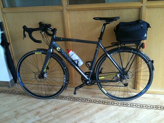

Here's the picture of the missing stay, and the full bike without the panniers.
Hope this helps.

Front one is a bit high, can you make or get an extension?

Not sure the back one would catch all the crud either? Not being critical but as above the CX is a bike I am looking at for the winter.
If you're handy you could probably make one - I'm not sure if you can buy one, but I haven't really looked. I haven't seen it as a priority because the guard still works perfectly. It's just aesthetics that would make me try something. It's only 3 months old, so I'll probably get round to it soon.
The back is catching everything. It is a bit further away from the seat stay than I would have liked, but it just needs a couple of washers and it will be much better. Again, it's just aesthetics in my opinion as I've had no problem with spray etc.
