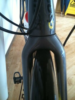

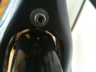

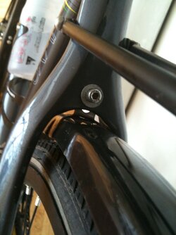

The rack will be fine. My only concern is whether the forks and rear seat stays would have enough width to take an extra 10mm.
See photos attached. Front probably ok...:thumbsup: Rear maybe not :sad:
It will be close, you may have to take it to the LBS and try it...
Cheers, and thanks for the photos.
Yeah it looks like some more investigation is needed.
