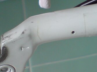

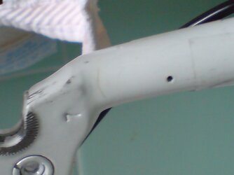

I think, out on the bike on Sunday noticed some very strange noises when climbing or in a big gear, got the bike home gave it the once over and saw this, DSC00130.JPG DSC00131.JPG it's the one nearest the dropout, i've only had the bike for 3 month's, made initial contact with the shop yesterday who obviously want to see it, but i can't get there till Friday, so just wanted to gauge other opinions as to whether it looks cracked or not.

I think that what you are seeing is a witness crack that forms in thick paintwork at the junction between the frame tube and the lug. I found one in exactly the same place on my carbon Specialized Roubaix and despite having hammered the bike hard including banging over some cattle grids and bunny-hopping potholes it hasn't shown any signs of worsening. If the frame wasn't so thickly painted with a layer of brittle paint and lacquer you would be none the wiser to the slight movement that takes place in this area.
The noises you heard were probably unrelated - maybe a creaking pedal or handlebars? If it had been the frame I think your crack would have been much bigger than that because there'd be definite movement.
Certainly take it back to the supplier though because I may be wrong and they may have had a whole lot of complaints on the same problem.
Be glad that you spotted it when cleaning the bike because the cleaning routine is your chance to examine everything carefully. Here's a pic of mine:

I don't like the look of either of these cracks, However, I'm not an expert.
If it was my bike I'd definitely be heading back to the shop.

Believe me, I went through the same worry when I discovered mine! I spoke with a carbon frame repairer and he told me not to worry, unless there was creaking or movement it was almost certainly a witness crack in the thick brittle paint (and it is brittle, you should see how it has chipped at the dropouts). That was around 800 miles ago on worn-out top-dressed tarmac, cattle grids and bunny hopping and still the crack is no worse.
No sorry, the other one's not a crack, that's the edge of the Helicopter tape that i've put on, it's just looks like that due to being a bit dirty.

Right, managed to get away from work early today, so took the bike back to the shop, and my fears were confirmed, the guys in the shop agree and say it's defo a crack, they were really sympathetic about it, and while i was there contacted the manufacturer who have asked that the shop send them the frame ASAP, so it's going back today and in the meantime the shop have loaned me a carbon framed Bianchi (which i don't like) to get about, i'll update further once i get a response from the manufacturer.
