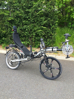

Things are coming together at last!
Dry day + quiet BH roads = Bent time so, after a stalled start to hastily fit a bottle cage to the stem (as lowering the seat means the factory bottle cage is little use for a decent size bottle), camera on as well, Gimme a ride...
I'm gelling with the USS nicely now and not over-steering anymore, relaxing on the bike and trusting it to 'do the right thing' seems to pay dividends.
I am sliding forward in the seat and there is a definite 'shimmy' when I'm pushing bigger gears downhill (27mph recorded already, blimey), this disappears when coasting. Climbing is MUCH better with the new gearing, so much so that I dont want to take 'Enterprise' off the road again to sort the cables out under the seat, so I'm NOT going to - thats what cable ties were made for, weren't they?

A piccy from yesterdays spin:
Cheers - Frank
