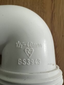

Here is the bend part

That trap is a Nuflo shallow bath
https://www.jewson.co.uk/p/polypipe-nuflo-traps-bath-trap-and-seal-40mm-white-PBPT1225
try Jewsons for a seal replacement or go the whole hog and turn the trp clockwise to remove the right angle joint and go straight into the long run (depends on how it connects to the right of the photo)
That Nuflo trap is a shallow seal & should not be used if the waste pipe is connected directly to the soil stack. The existing waste pipe is to the rear of the bath, that's why a swivel trap was used originally for easy connection. The threaded elbow that the OP has removed is an integral part of the deep seal trap & should not cause any issue whatsoever if correctly installed. The main issue that's caused this leak is the unsupported waste pipe is sagging/under stress in the area of the push fit elbow adjacent to the trap (you can see that the short stub of pipe is angled sharply downwards where it enters the compression joint on the trap).
