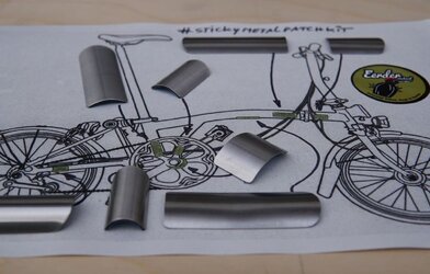

Biggest areas of wear and tear on mine are...
Main frame where the gear cables and rear brakes run over the top. It looks dirty rather than worn, but won't come off the powder coating.
Chainstay on drive side. Worn through the powder coating to the metal.
My Brompton sticker looks awful too - it's all mangled. Though I assume I must have kicked it when getting on. Didn't happen at first as I still used to swing my leg over the saddle for the first few months after getting it.
For some reason the wheel nuts on mine rust terribly and so has the external collar on the headset. None of which has a result on performance, but it does make it look a little uncared for.

3. Do you find that there are any areas of the bike that get a particularly hard life / require particular care or protection? For example, I see the rear wheel folds against the bottom bracket area of the frame; which over time I assume could damage the paint in this area.

3.if you are concerned about paint rub you can use heli tape or metal patches to protect the frame. See areas in the image below.
