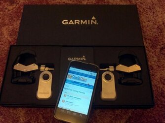

Here's another excellent review for Vector:-
http://road.cc/content/review/94115-garmin-vector-power-meter-pedals
There is so much more functionality with this when paired with a Garmin head unit. Future firmware updates will give data on Pedal Smoothness, which is a measure of how even your pedalling stoke is over one revolution and Torque Effectiveness which is a measure of positive and negative power-ie how much your are pushing down /pulling up.
Bit of a no-Brainer really, I'm off to buy them!:bicycle:

After back to back testing with my SRM and Vectors, I find that I am getting repeatable and comparable results.
As such I have sold my SRM and now have an additional set of Vectors...
The reasoning for this is simple, they produce consistent results which are comparable to my SRM figures, they are lighter, they do not need to be returned to the manufacturer when the battery needs replacing, they are easier to swap between bikes and will continue to evolve through software updates.
I will likely replace all my power meters in time with the Vectors, Im very happy and impressed with them.
I am even going try to modify a pair for the MTB :biggrin:
