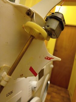

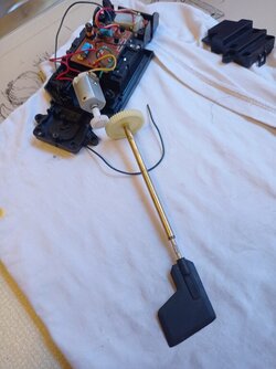

I have got further on with my 'cobbled up' 7000.
The RC car 'rack motor', for turning, is going to be vertically mounted inside the stern and a 'letterbox' slot will allow it to engage/rotate the larger gear on the rudder post. A limit peg will prevent movement beyond a certain arc...

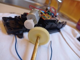

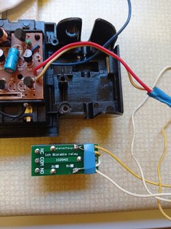

My 5V relay arrived.... I have soldered the car 'drive motor' wires onto the coil terminals & tested with the 7.2V boat motor = works great! 👌

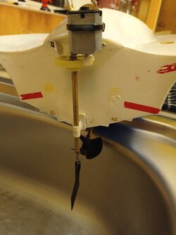

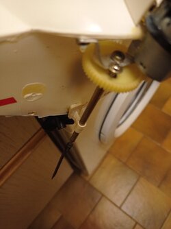

Some jiggery-pokery required to get the Rudder sweeping the full arc - stop screw for limit.
Installing motor tomorrow.....

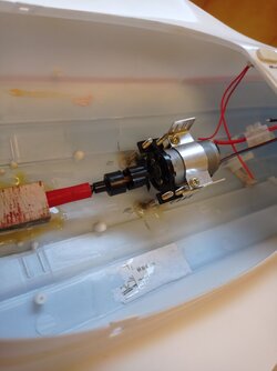

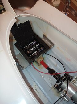

Motor in.... UJ connector installed in driveline.
The RC car 'chassis' (front & back cut off) installed to run the control voltage [3x AA] and it is low to c/g and over the prop. Neat hinged lid arrangement.
