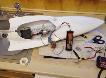

My RC boat [Frankenstein toy car] mash-up is now complete 👍
Tested for buoyancy and prop/rudder performance, in my bath....
Will put up a YouTube when we get out to the local Duck Pond.

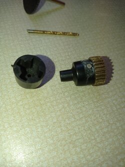

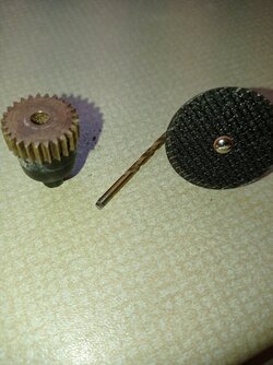

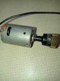

I have now constructed/cobbled up... my 25T driver cog, for the boat drive.
I pressed the brass cog into a spare u/j cup, holding the two in my hobby vice.
I drilled a through hole and (having no suitable pinning wire) then cut the shank off the drill & glued it through, securing them tightly.
I removed the pair from the vice and tapped them onto my motor shaft.
It looks 'rough n ready' but, hey.....

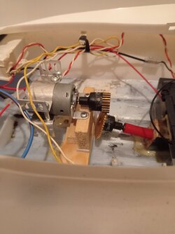

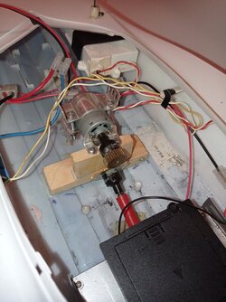

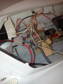

Motor installed, just need to wire it up for correct prop rotation..... Then >>> bath test!!
