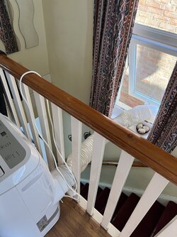

The main problem is venting it. I purchased one last year ready for this year, it works very well within about 5foot of it, but venting it is always an issue and you shouldn’t extend the vent hose.
Currently it’s in the middle of the landing with the vent hose stretching across the stairs to go out the stairway window. It can get the landing from 26C to 18C but the bedrooms still stay about 24. I’ve set up two fans either side trying to blow some of the cold air away.

What do you mean by venting it @DRHysted ? Is that the inevitable drain for water? If it is why can't you extend it as long it runs downhill?
No….portable air cons come with a vent pipe, to vent hot air out the window

I remember them setting one up in a portakabin / office at a former employers, they couldnt figure why it wasnt cooling the room. No-one thought tò set up the vent, there was as much hot air coming out the back as cold air coming out the front :laugh:
We have one of these. Had it over 15 years. Other than a good hoover out of the fins inside, its been essential in our house, usual modern house that holds heat, costs bugger all to heat all year round, but cooling an issue.
Uses about 1kwh.
They are all a bit noisy.
