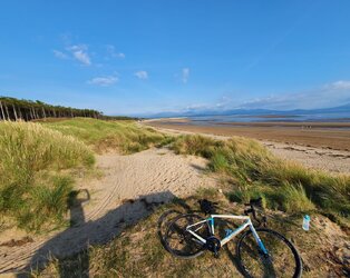

By way of an example, Newborough Forest Anglesey ... right on the limit with 32c slicks but made it there and back, eezy peezy with 38c knobblies.
