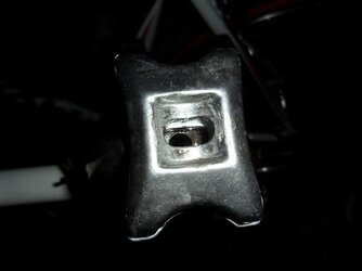

Hit a bump and the saddle tilted upwards, made the remaining ride home a bit "interesting". Anyhow got home, loosened bolt reset saddle at the right angle tightened and then "crack" now the threads are stripped, and I can't seem to find a replacement, tried LBS etc, the problem is the nut that sits in the upper clamp, I think its quite size specific to fit in the recess in the upper clamp, any ideas where to find such a thing?

Could you post pictures of each side of the saddle showing the hole that the bolt goes through?

Thanks, here's a view from above and the recess is where the clamp nut sits, and the view from the rear shows the clamp on the seat post minus the bolt of course. clamp 1.JPG clamp 2.JPG
I realise the bolt is easy to find, its an allen headed bolt, its the nut that's the difficult thing to source

If you are a practical type it would be easy to make one. A length of suitable diameter steel rod cut lengthwise into semi-circular cross section, drill and tap to appropriate thread.
If not, perhaps a little scrounging at a long-established lbs might get you one from the scrap box.
Is there room enough between the top of the nut and underside of the saddle for another standard nut? If so, and you could get a spanner in there, you could drill the stripped thread out to clearance size for the bolt and use the standard nut to tighten the lot.

I would suggest a dowel or barrel nut, here is one yesterday.
Note that these are for furniture and made of cheesey steel so you want one that is 8.8 or 12.9 grade.
I doubt you can get them in that sort of strength so DIY way would be to find a high tensisle bolt of correct diameter, cut to length then drill and tap.
You could use a washer and nut but you need the "roundness" in order to be able to adjust the saddle.
